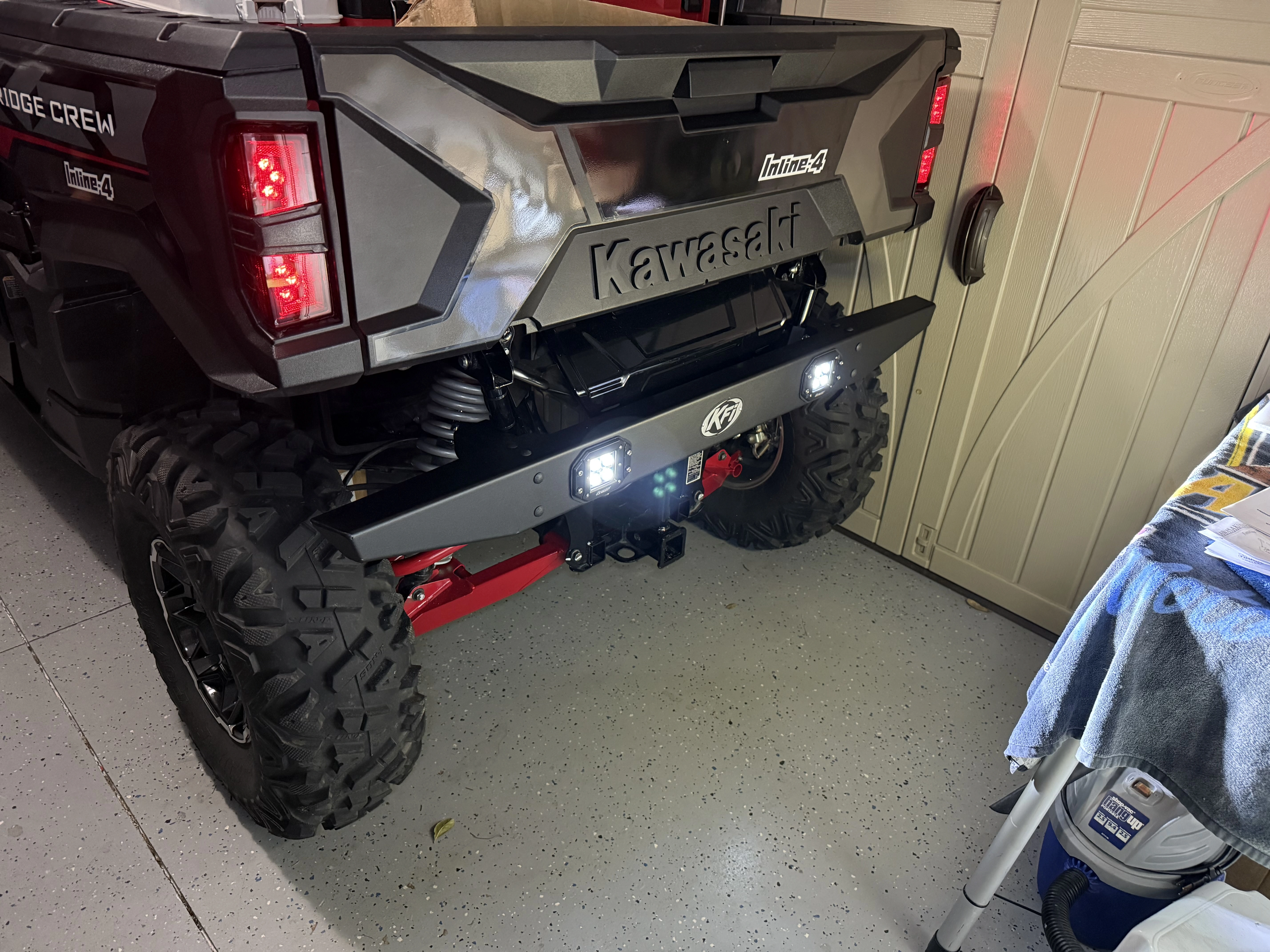

I just installed this rear bumper with the lights. The lights are nice and the wiring harness is of great quality with an illuminated switch. I didn’t use the switch. I connected wiring to back up beeper with the relay so they turn on when I put the unit in reverse. I do have a concern about the location of passenger side light and the exhaust tailpipe. They are in close proximity. Overall I would buy this bumper again. It’s strong and looks excellent.

I like how that one doesn't connect to the bed hinge like most of the others. And I can see what you mean about the exhaust being close to the light. Hopefully it doesn't cause any problems

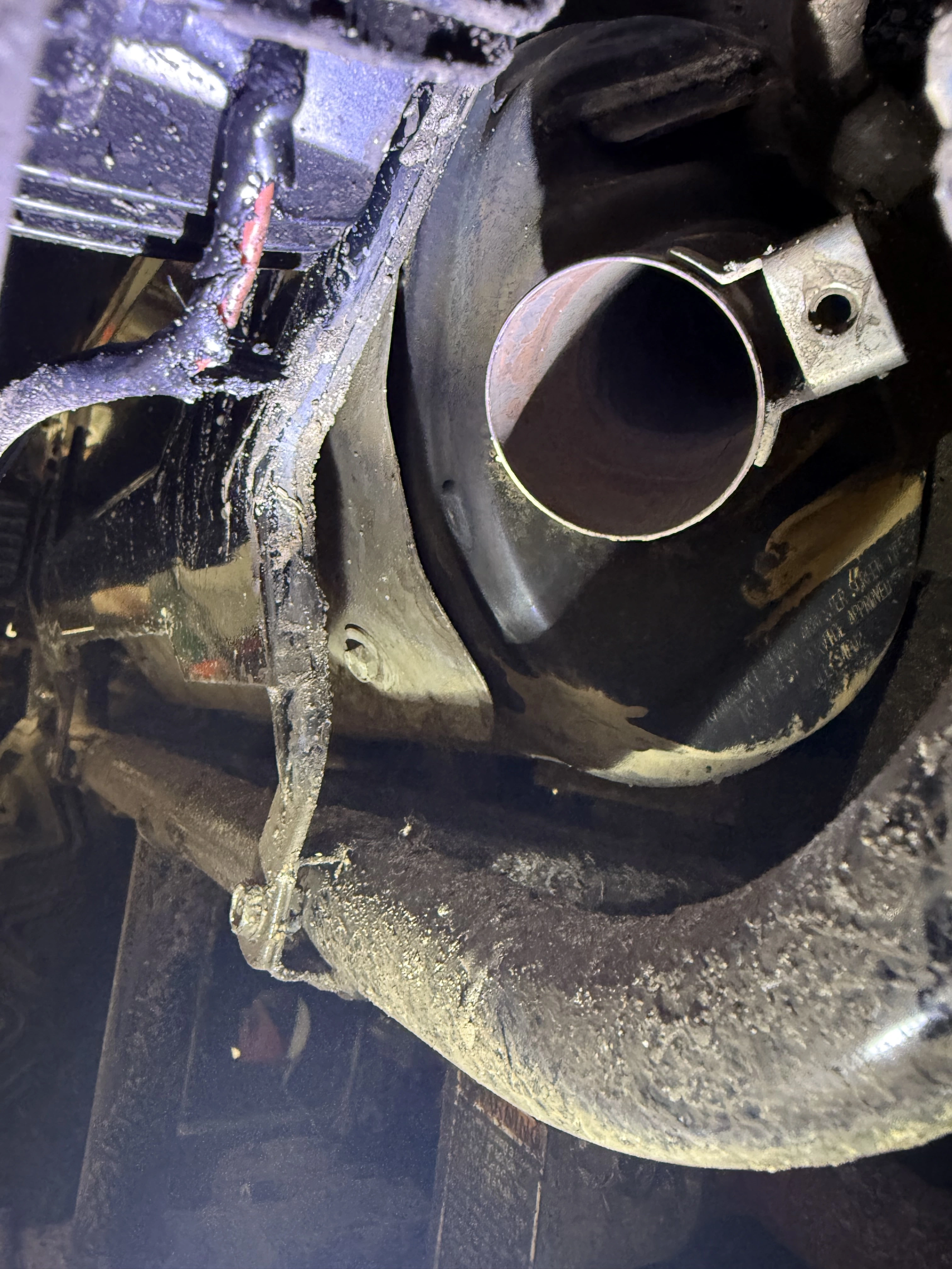

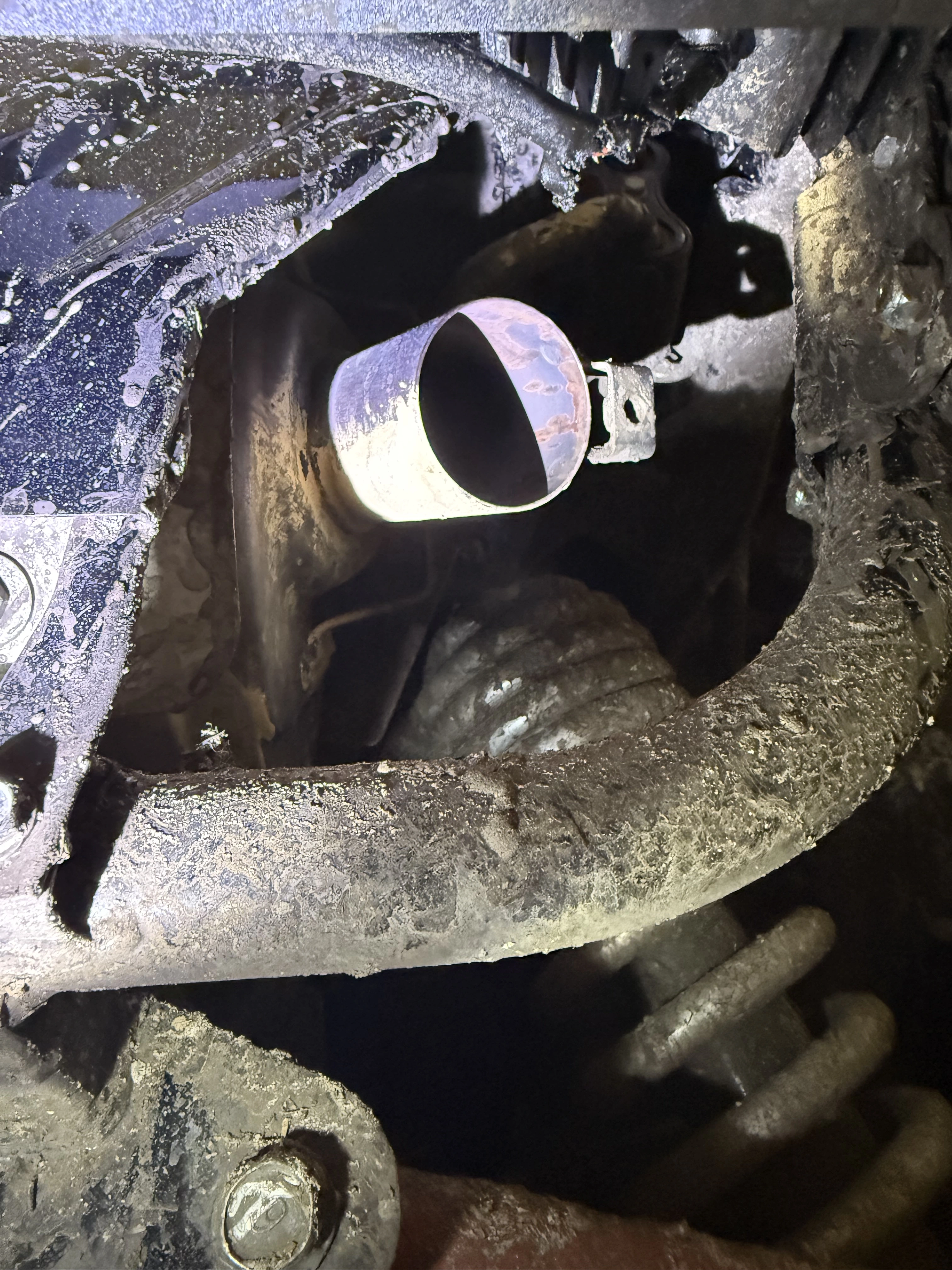

Update,
I took my Ridge out on Sunday and my wiring for the lights took a beating from the exhaust. The outer cover melted but the inner wires held up. I’ll have to flip the passenger side light upside down or attach some heat shielding.

I wonder if there is a tip to put on the exhaust to get it down below the bumper
I installed the bumper at 3 inches from the top as directed. There is clearly an issue with clearance. Love the bumper though.
From what I have experienced with KFI so far, they drastically lack foresight. I have their winch mount and poly plow. The winch mount is fine. The plow is mostly fine but has many things that could be better
