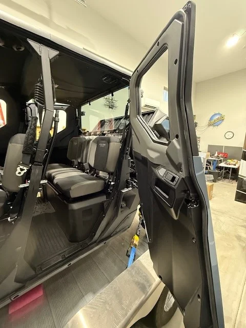

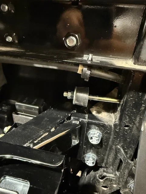

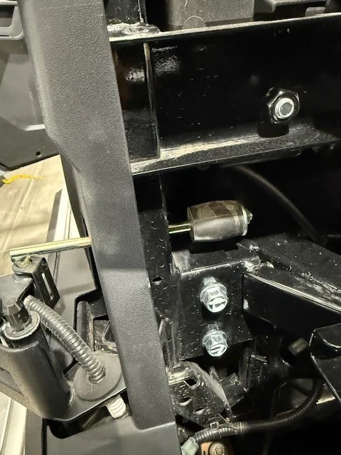

If you are looking for more rear door opening space, there is a simple 5 minute solution. First pic shows the Left rear door stop-rod with 2" long rubber stopper in place, just behind rear firewall. Second pic shows Right rear door stop-rod with the rubber stopper cut in half (1") and reattached to stop rod. Third pic show left door open almost 90 degrees or about 10 inches wider than normal. Simply remove the nut attached to the end of stop-rod and cut the rubber stopper shorter to your desired door opening. Ridge Crew Limited 2025.
