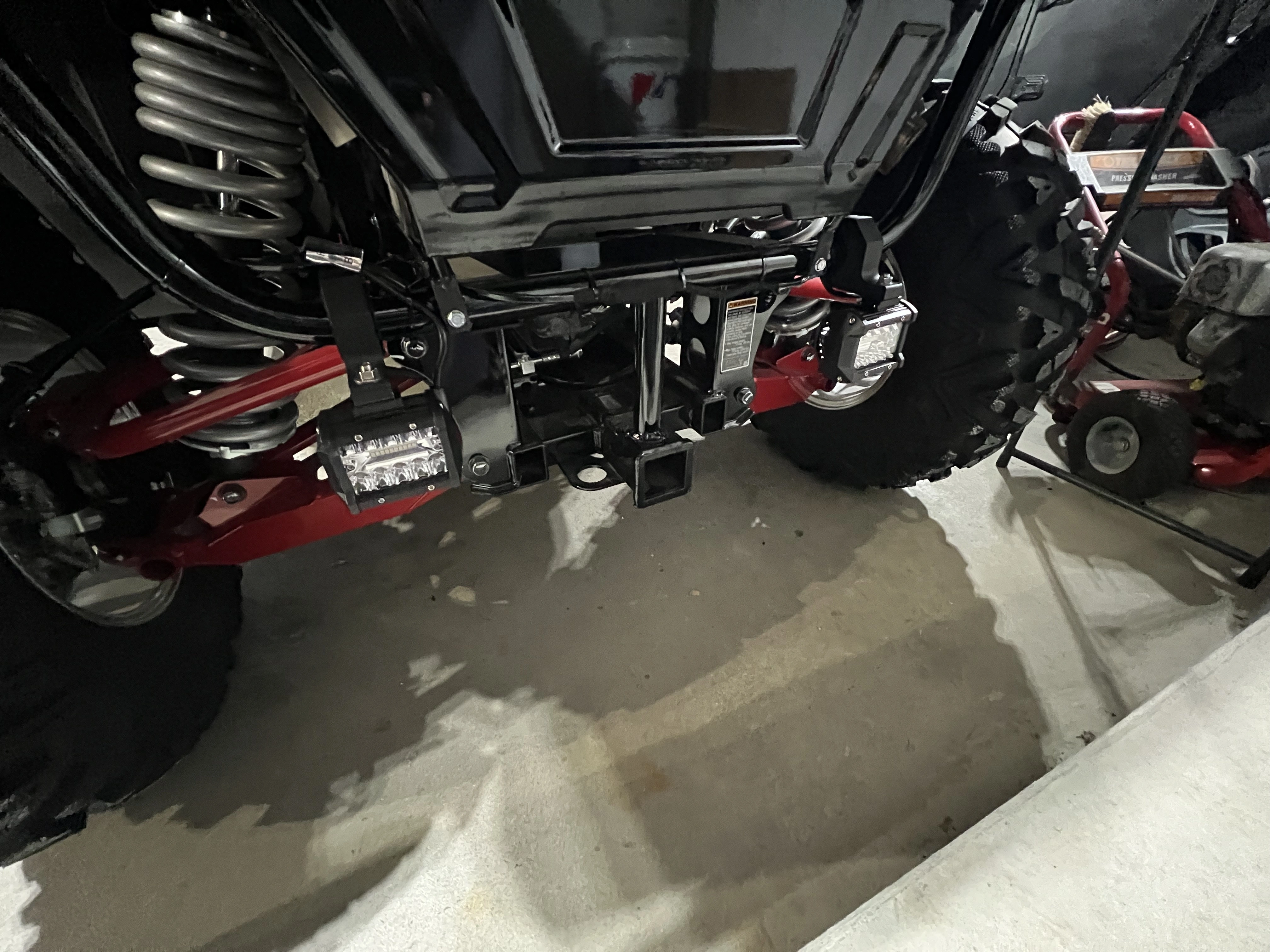

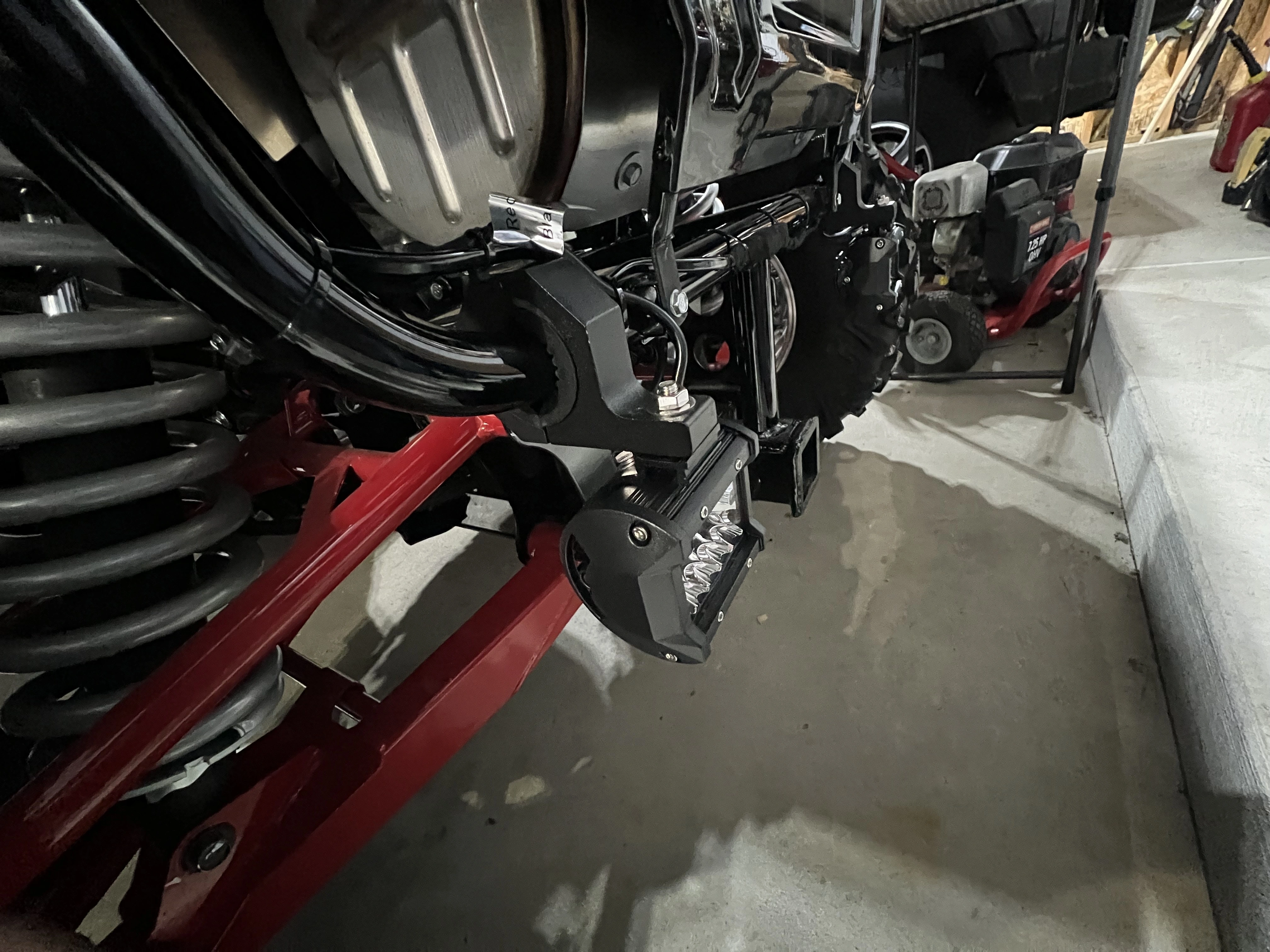

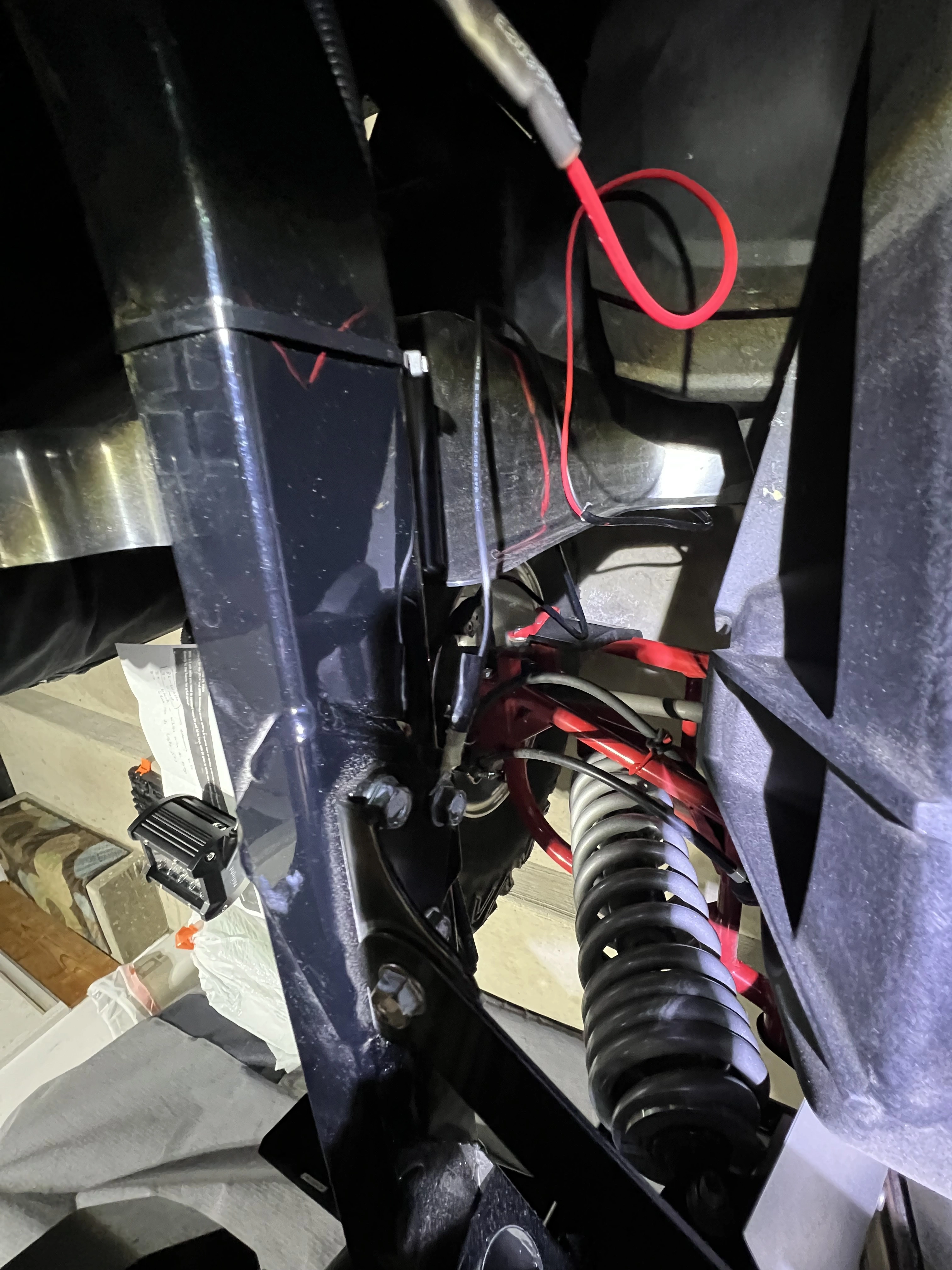

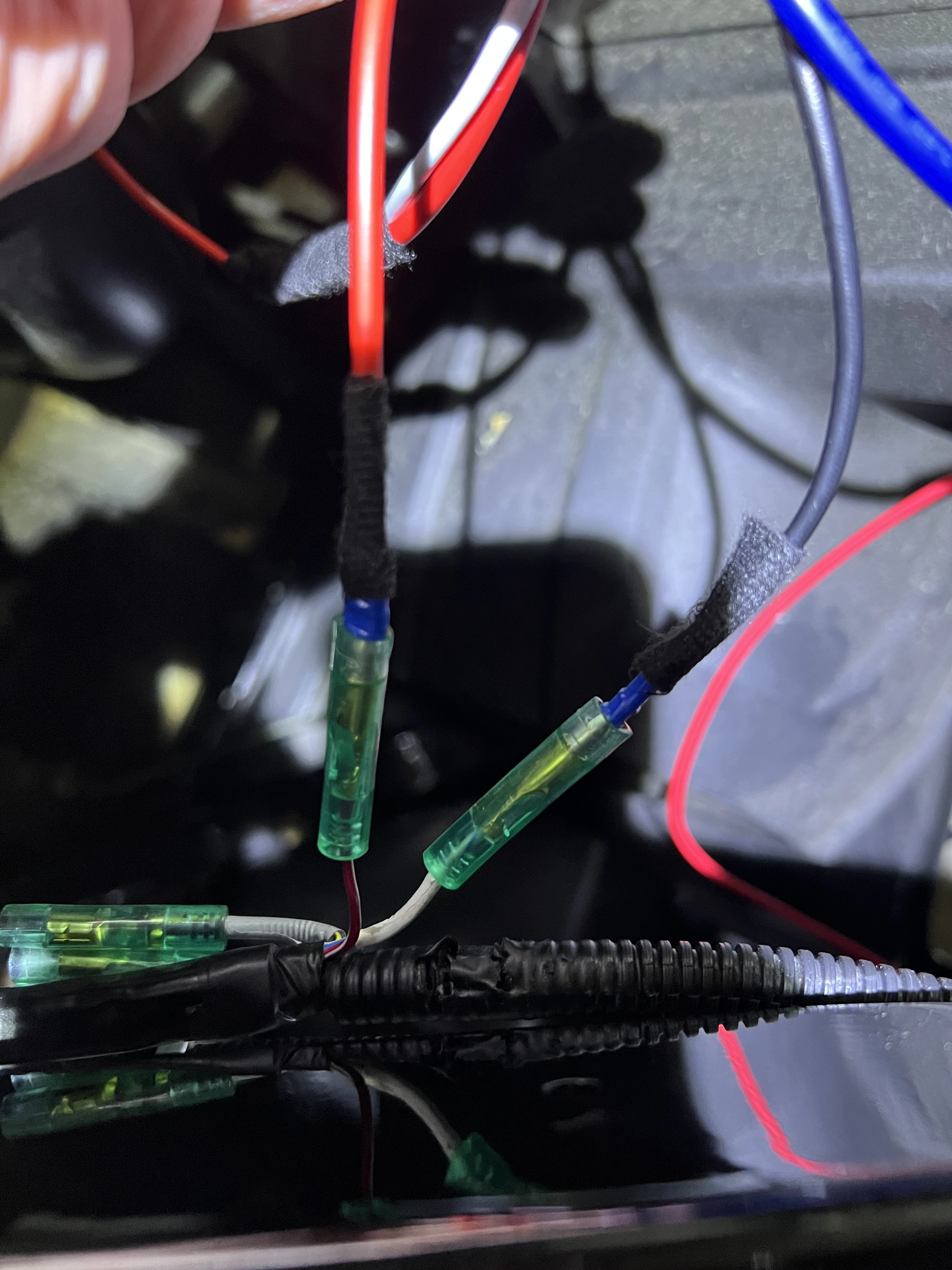

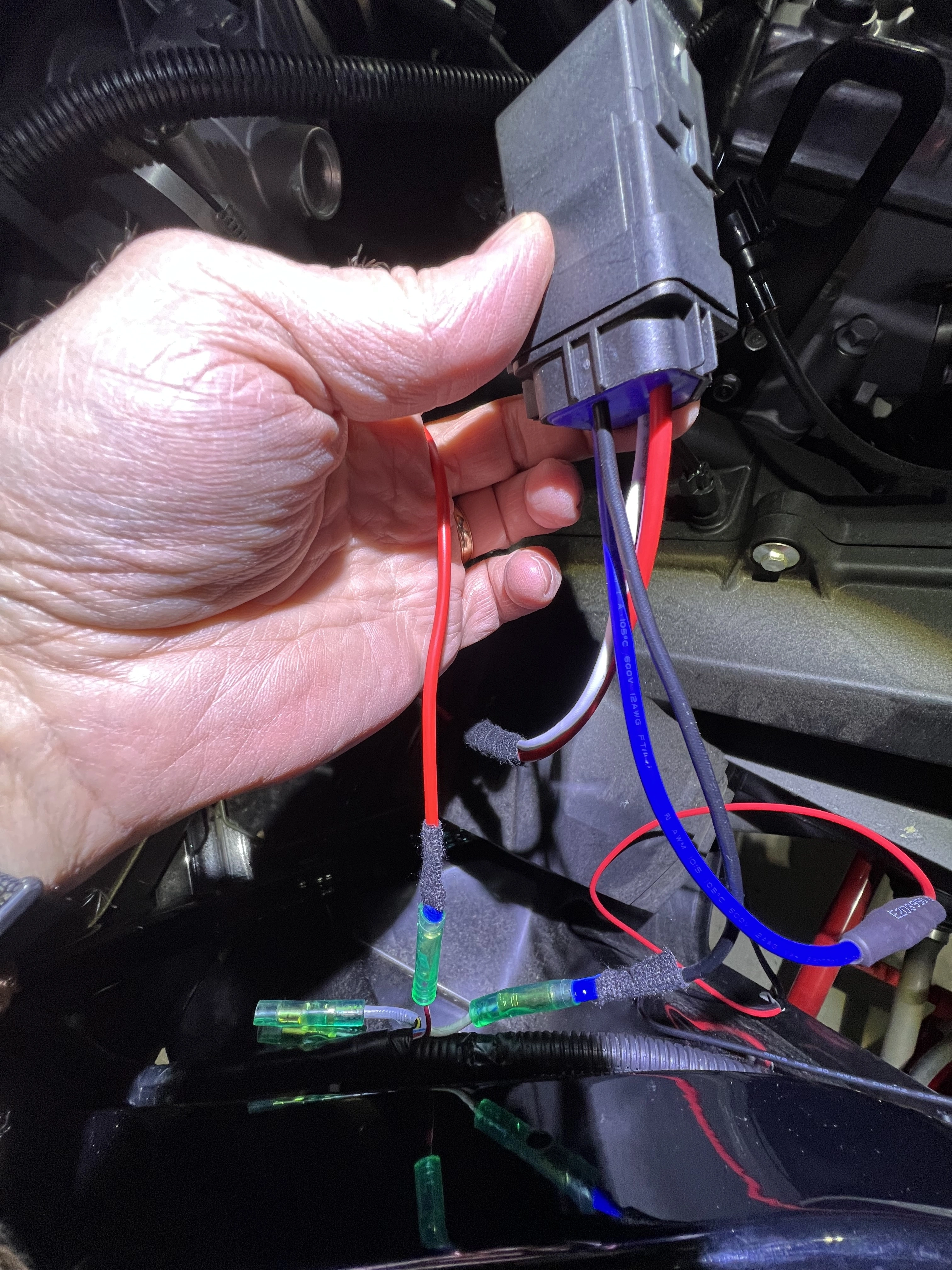

Here is how I wired reverse lights on my 2025 Ridge.
I started with this YouTube video below.
Important note: The lights will come on with vehicle running and gear in reverse. The lights will not come on if the vehicle is not running
YouTube video -
Parts
Lights: https://www.amazon.com/dp/B07D5S1SF5?ref=ppx_yo2ov_dt_b_fed_asin_title&th=1
Relay: https://a.co/d/7PXOR1h
Mounts: https://www.amazon.com/dp/B0714CYKBJ?ref_=ppx_hzsearch_conn_dt_b_fed_asin_title_5&th=1
Fuse holder: https://www.amazon.com/dp/B07B5Y2ZJD?ref=ppx_yo2ov_dt_b_fed_asin_title&th=1
Wire: https://a.co/d/farAXrv
Bullet connectors: https://a.co/d/aUNavCg
Fuse relay wiring
86 (white) and 30 (red) connect both together and insert inline fuse, then connect to → red w/white stripe accessory wire on the Ridge (12V+)
85 (black) → white wire on the Ridge
87 (blue) → to lights as 12V+ power (connects to red wires from lights)
Ground your lights directly to the frame as shown in my pictures.
