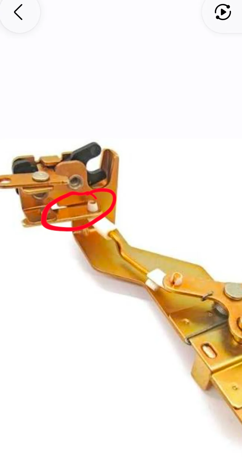

The problem is the link between the outside door handle and the latch. All you have to do is make it a little bit longer by taking some of the two beds out a bit. It needs to be about a mm or 2 longer than it is.

I did both of my doors in a little over an hour and that included figuring out the problem.
If you straighten out the link a bit and it doesn't work for some reason or it makes it worse you won't be able to tell you did anything as far as warranty.

It has been a few weeks and still no door popping issues. I am thinking that the hinges might need a little adjustment as well just to get an easier closing door. But I still highly recommend getting the latch to a free state by bending that link. It doesn't take much. Go a little, test fit until you get the arm resting against the latch body.

I know this post is a little old, but wondering how your latch fix has been holding up over time. I recently traded in my 2024 Ridge (open cab) and purchased a new 2025 Ridge limited enclosed unit. However, as soon as I got it home and on the ranch roads the passenger popped to the safety latch and rattles. I have done all the adjustments that I can think of, issue still persists. I have contacted dealer (2hrs away) and they say they have never heard of this issue (It's a first)....Lol.....So, to save taking it back and waiting weeks to get it back and run the risk of it still not getting fixed, I started scouring the web and see all kinds of posts about the door issue (shocker Kawasaki doesn't know anything). Anyways, I read your posts and straighten the latch rod makes sense versus grinding on it and ruining the latch. Today, I tore it apart (pretty straight forward) and did a little straightening ( and a little testing) and thought it was good to go. Road around for a few minutes and no pop, thought it was fixed. A few hours later loaded up and headed out to go check cattle and about 3 miles out, pop, dang thing stared doing it again ( all though not as bad as previously). So wondering if I didn't straighten it out far enough or maybe it truly is a faulty latch. Thoughts? Ideas? Thanks and have a great weekend.

So far so good! I do need to adjust the hinges a bit but the latch has been fine. Just have to make sure the door gets shut all the way.
On the end of the latch end of the rod it connects to a vertical link. That link wants to be just touching the body of the latch with everything at rest. Straighten the link until it just touches and see how that goes. If you go too far you will just lose some outside door handle travel. Probably not a big deal unless you go way too far. And if it doesn't work, take it back for new latches. Good luck!
